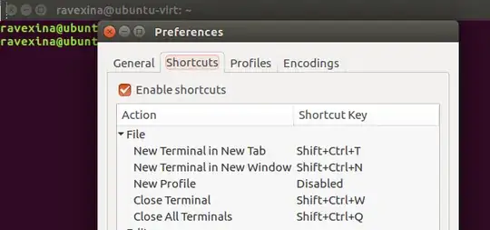

  1. change gnome-terminal preferences to default if you have changed it.
    so, set the Ctrl+Shift+t as shortcut for opening a new tab.

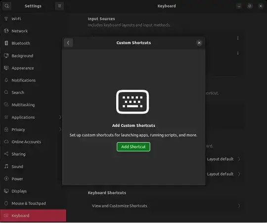

  1. Open up Settings > Keyboard > View and Customize Shortcuts > Custom Shortcuts (scroll to bottom) Navigate to Custom Shortcuts
  2. Add a shortcut with any name, the command /home/USER/.custom-terminal-key.sh, and bind it to Ctrl-Alt-T Add Terminal Shortcut
