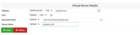

Webmin > Servers > Apache Webserver > Virtualhost: enter image description here

Did I setup virtualhost wrongly using Webmin's method?

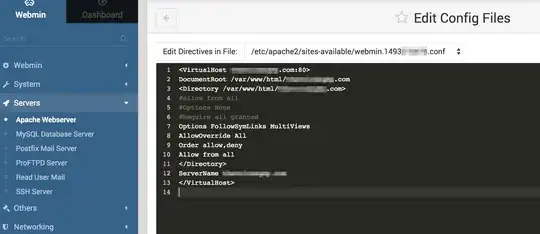

Once I added a virtual host via webmin,
I will need modify sites-available .conf and add these codes to wrap inside my domain's <Directory> :
Options FollowSymLinks MultiViews
AllowOverride All
Order allow,deny
Allow from all
