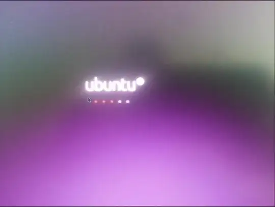

My ubuntu is not shutting down. Shutdown is Frozen
Freeze
Note : grub default acpi=force or reboot=force, EFI not run.
  • System : MSI GE60 2PC Apache
  • Graphic Drivers : Nvidia-375(ppa:graphics-drivers/ppa repo)
  • Prime-Select : Intel
  • Ubuntu : 17.04 x64 UEFI
