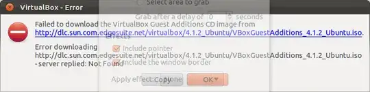

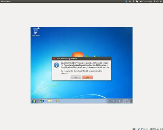

Now the problem is when I try to install the VirtualBox Guest Additions I am getting the following error.
Screen Shot1
Screen Shot 2

You could install Guest Additions from terminal, using this command:
 sudo apt-get install virtualbox-guest-dkms
I got this same error and then realized that I needed to explicitly tell Ubuntu Software Center to install virtualbox-guest-additions-iso.
