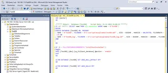

If you don't want to work with command-line tools, you can connect with SSMS from a windows laptop.
SSMS
