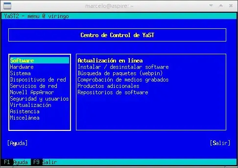

When I do a ssh to an OpenSuse machine and use yast I have to use tab intead of alt+y for help for example, I don't know what else to say...
My question is how to set up this to have a propper xterm console.
additin:xterm and/or LXterminal maybe this one has some features to add, really don't know.

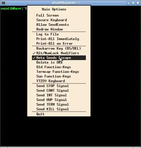

On xterm, press the Control key and at the same time left-click somewhere on the xterm window.
A menu should appear, where you can select "Meta Sends Escape" that should do what you ask
To set this option as default, create a file of name .Xresources in you home, and put the following line into it:
XTerm.metaSendsEscape: true
then restart your session.

As a follow up to the accepted answer, XTerm.metaSendsEscape is now XTerm.vt100.metaSendsEscape. According to the documentation for xterm:
The following resources are specified as part of the vt100 widget (class VT100). They are specified by patterns such as “XTerm.vt100.NAME”.
If your xterm is configured to support the “toolbar”, then those patterns need an extra level for the form-widget which holds the toolbar and vt100 widget. A wildcard between the top-level “XTerm” and the “vt100” widget makes the resource settings work for either, e.g., “XTerm*vt100.NAME”
(metaSendsEscape is among the resources specified in the VT100 class)
The full declaration in Xresources should be
XTerm.vt100.metaSendsEscape: true
