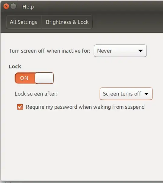

On my freshly installed Ubuntu 17.04 lock screen appears about 5-10 seconds after I press Win+L or "lock" button in the upper right corner. During these 5-10 seconds nothing is happening. As if I didn't press the button.
How do I reduce this lag? I want it to lock immediately.
"Lock screen after" is set to "screen turns off":
screenshot of Brightness & Lock settings

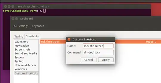

I searched a lot to find anything (configuration) that may be related to this lag but to luck. It seems that there was a known bug [old]. anyway we still can use other tools to achieve what we want unless that bug is effecting you which you can use the above link instruction to get rid of it..
First use these commands to lock your screen, see which one of them is work better for you and which one you prefer to use.
$ dm-tool lock
$ gnome-screensaver-command -a  # starts screen saver
Now open system settings go to keyboard section and shortcuts tabs.
Now you can select custom shortcuts and asign something Ctrl+Alt+l to a command like dm-tool lock; Cause by default we can't use Super+l.
However if you insist to use Super+l to run your preferred command, set it as your key-binding and follow along to make it work.
To disable unity's Super+l key-binding, run:
dconf write /org/compiz/profiles/unity/plugins/unityshell/lock-screen "''"
To restore default behavior:
dconf reset /org/compiz/profiles/unity/plugins/unityshell/lock-screen
or install compiz setting manager:
$ sudo apt install compizconfig-settings-manager
then run it:
$ ccsm
Go to ubuntu unity plugin section. on line two, Key to lock the screen, click on the button <Super>l, uncheck the Enabled check-box click on ok.
