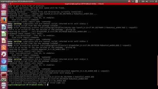

Now that I have upgraded my Ubuntu to 17.04, the package system is broken. When I execute any APT commands, I get some error.
sudo apt --fix-broken install returns
dpkg: warning: subprocess old pre-removal script returned error exit status 1
dpkg trying script from the new package instead...
dpkg: error processing archive /var/cache/archives/... (--unpack): there is no script in the new version of the package - giving up

The problem is with the click package. You most likely have a python3 version of click installed through pip3. You just upgraded to 17.04 and have the click package installed with a version number under the pip or pip3 repository. Pip packages aren't managed by apt, and they take priority when Python's import keyword is invoked. So you need to uninstall the click package and then reinstall it.
Install click again to install the dependencies.
sudo apt-get install --reinstall click
Then remove it with this command.
sudo apt-get autoremove -f click
If that doesn't work, you can try it the hard way,
sudo rm /usr/bin/click
