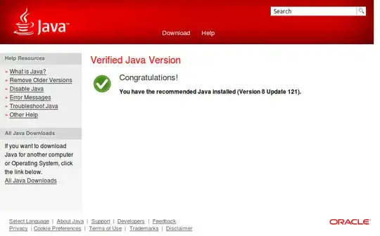

I have verified that the java plugin is working, by going to this page.
