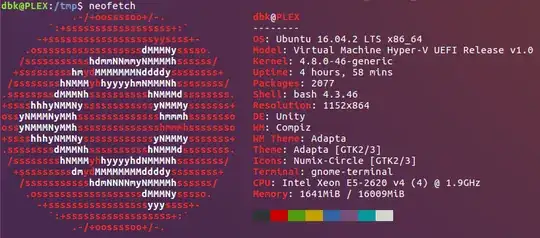

    system info

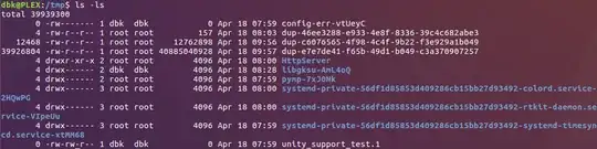

  • There's a file in /tmp that grows at a rate of about 10GB per hour. I have no idea which process is responsible for this. (it's the big one: dup-e7e7...)
    huge files with dup name prefix

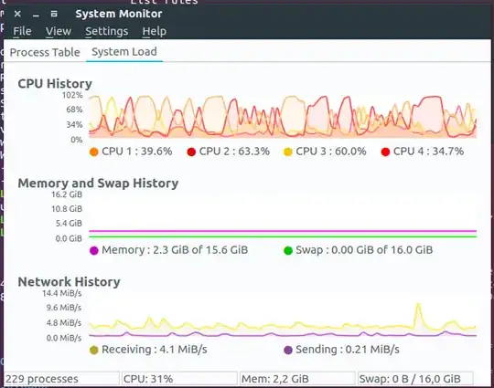

  • KSysGuard shows an almost constant CPU usage of over 30%
  • KSysGuard also shows a constant stream of incoming network traffic at a rate of about 5MiB/s
    System Monitor window

It was related to backups. Logged into Duplicati and stopped the automatic backup. It seemed it was constantly trying to backup my system, but never succeeding, as there are no finished backups.
With Duplicati stopped, the dup files don't grow anymore (well, they do, but nowhere near as fast), so it's definitley related to this. CPU usage percentage dropped from around 30% to about 10%.
