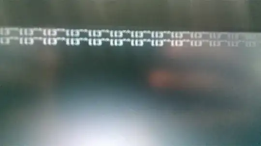

A message like this ^3[[^~ shows when i turn on my laptop, the message still show up even in terminal. When i want to install app using command sudo apt install, error message with these ^3[[^~ shown up.
Can Anyone give me a solution how to solve this?
Rinzwind
  • 309,379
From the comments...
Looks like you've got a jammed key on your keyboard, or a defective keyboard. If this is not a laptop, unplug your keyboard and see if the problem goes away. Otherwise, look closely at your keyboard for a jammed key.
response: yeah, its my keyboard broken. the DELETE key always pressed
