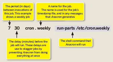

Cron is designed for machines that are left running continuously. If your machine is turned off when a job falls due, it simply won't be run. To handle this situation better, a new tool called Anacron was written. anacron's mission is to guarantee that those daily, weekly and monthly activities do actually occur, assuming only that the computer was switched on at some point during the day. It does not record hours, minutes or seconds, only days, months, and weeks.
It's conf file is -> /etc/anacrontab
Anacron is run at boot time, via the script /etc/init.d/anacron.
Anacron does not expect the system to be running 24 x 7 like a server.
When you want a background job to be executed automatically on a machine that is not running 24 x 7, you should use anacron.
if you have a backup script scheduled everyday at 11 PM as a regular cron job, and if your laptop is not up at 11 PM, your backup job will not be executed.
However, if you have the same job scheduled in anacron, you can be sure that it will be executed once the laptop come back up.
It is Ideal for desktops and laptops.
