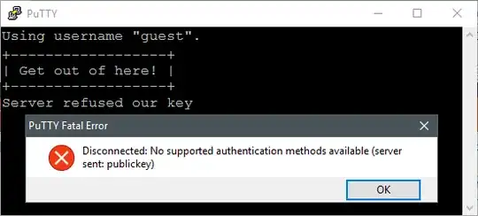

The result would be:
EDIT:
Please note regardless in the above example PubkeyAuthentication is available and there is a valid /home/guest/.ssh/authorized_keys file the user will get Permission denied (publickey).
If PasswordAuthentication is available the user will be asked few times for their password and in the end will get Permission denied (password). So if you want to further tease him (or her), change the above directives in this way:

The result of the above will be identical as the result of the first suggestion but the message Permission denied (publickey) (Server refused our key) will not appear.
