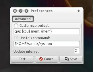

Then in the indicator-preferences:
click "use this command" and copy and paste the following text:
$HOME/scripts/sysmon
