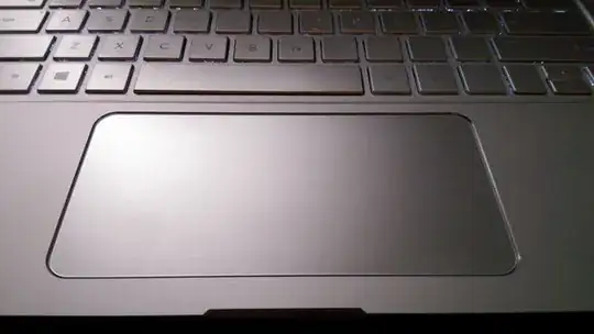

I just installed ubuntu 16.04 as a dual boot with (pre-installed) Windows (just in case I need it twice a year...) on my new HP Spectre x360 13-ac004nf. Under Windows, the touchpad works fine and intuitively, but on Ubuntu it's almost unusable. The problem is that the zone of the buttons is sensitive. In other words, the touchpad does not look like that:
but like that:
And everytime I lay a finger on the left button zone (not clicking), the pointer stops moving because the system detects a two-finger gesture. Here is the configuation returned by synclient:

I tried to play with AreaBottomEdge, but it only disable the moving detection... Which means that the touchpad still detect that there is another finger touching it, and it enters double-fingers gesture mode (scrolling). I would like my touchpad to behave like a touchpad with separate buttons (like the first image) and not detect anything over the zone of the buttons. How to make that happen?
