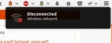

But when I click on "Connect to Hidden WiFi Network" and choose to start the hot-spot setup, I see this notification and it doesn't start.
Wireless Disconnected
How should I resolve this?

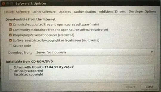

  2. Click All Settings > Software and Updates
    Make sure the settings shown are checked.
  3. Click the Close button and let Ubuntu 17.04 update after entering the password. Wait for it to finish. Click Reload.
