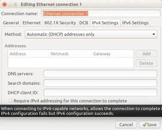

First... DON'T manually edit /etc/resolv.conf... it says so right in the file... 'cause your manual edits WILL get overwritten. Also, DON'T start deleting symlinks/etc if you don't know what they do.
The proper way to add DNS servers is to edit your connection profile. Go to the IPv4 Settings tab, change the popup to "Automatic (DHCP) addresses only", and place your DNS servers in a comma-separated list where it says "DNS Servers".
Update #1 - from DNS_PROBE_FINISHED_BAD_CONFIG error in Ubuntu 14.04 with corrections
In terminal...
sudo rm -i /etc/resolv.conf
sudo ln -s /run/resolvconf/resolv.conf /etc/resolv.conf
sudo resolvconf -u
