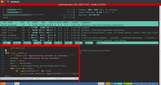

What you see in the screenshot is couple apps, actually. Tripple split is done by screen as suggested by the name in lower right corner in the screenshot and the process manager in top split is htop.
I personally would recommend byobu instead of just screen, since that has fancier interface showing clock, ip address, and other stats. All the apps are installable via sudo apt-get install PACKAGE-NAME
Here's for instance what can be done witih Byobu. Similar layout:
