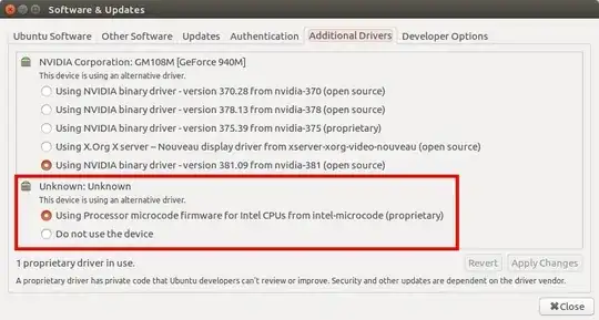

As you have confirmed in the comments, you had the use of Intel's "Procesor microcode firmware" driver disabled.
This microcode can be described as hot-patch for the firmware of Intel CPUs, which gets loaded and applied every time you boot Ubuntu (because it can not be written persistently) and fixes some bugs or improves some things.
More information could be found e.g. in the questions Unknown Additional Driver: Processor microcode firmware for Intel CPUs for intel-microcode and Should I activate the additional driver: Processor microcode firmware for Intel CPUs for intel-microcode .
To enable this microcode patch, simply open your System Settings and click on Software & Updates. Navigate to the Additional Drivers tab and wait until the list of drivers is loaded, which can take some moments.
Search for a device that has options mentioning "Intel", "microcode" or similar keywords. Most likely it is labelled as "Unknown" for whatever reasons.
Anyway, make sure that the option named "Using Processor microcode firmware..." or similar is the selected one. You probably should reboot for the changes to take effect after that.
Software & Updates > Additional Drivers > Unknown/Intel Microcode
