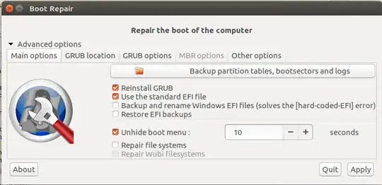

If lubuntu was installed with UEFI
Your first tab, Main Options, should look like this

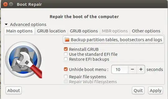

If lubuntu was installed with BIOS your first tab should look like this

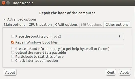

Your last tab should look like this regardless of what mode
