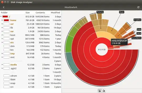

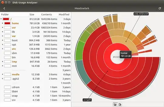

The reason I think that this is relevant to my lack of disk space is that Disk Usage Analyser shows that almost three quarters of my drive is taken up with one enormous encrypted directory. Here's a couple of screenshots to demonstrate:
The brown segment from roughly 12 to 3 is my usual home directory; Documents, Music, etc. It's the stuff that I'd hoped to encrypt, and the size looks about right for what I thought I had on the machine (there is only one user account). The bigger red segment is taken up with mystery stuff, all stored in a directory called ecryptfs.
I have seen people raise similar concerns in the past but with an ecryptfs directory the same size as the home directory, this is more like three times the size. My suspicion is that it became enlarged because of the difficulties I had encrypting the drive in the first place (I probably attempted to run the tool two or three times, thinking it hadn't worked each time). Either way the responses to those questions don't do much to fix the issue. So far as I can tell there is little practical difference between "the disk is nearly full" or "the computer just thinks the disk is nearly full because of a virtual ecryptfs file".

Baobab (the proper name of Disk Usage Analyzer) doesn't look into file systems mounted at subdirectories (here: /home/eddy) of the parent directory to analyze. Instead it only sees the content of the files inside the parent file system which happen to be the files and file names that back your encrypted home directory in their encrypted state. I found two ways around this.
1 Tell Baobab to look at your home directory specifically
To that end open a terminal and run:
baobab "$HOME"
I didn't find a way to do this reliably via graphical user interface.
