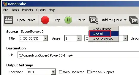

If you right-click on the "Add to Queue" button, you will see an option called "Show 'Add All' to Queue".
Click that and you'll get a new button called "Add All". Clicking on that will add all of the titles to your encoding queue.
Be sure to tick Preferences -> General -> 'Automatically name output files' so the files don't overwrite each other!
Check also the automatic file renaming format. By default it should be {source}-{title} (more information in the documentation). Adapt it to your source to get unique file name for each file.
