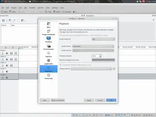

my system:
  • intel cpu
  • gtx 1050 ti
  • ubuntu suite 16.04
  • kdenlive 4:15.12.3-0ubuntu1 (got this with dpkg -l, think it is the version)
The GPU option in Kdenlive is greyed out, I read I have to have the movit-library (libmovit4) installed in order to enable the GPU option. Strangely, the movit library is already installed.
sharkant
  • 1,361
I managed to do this (finally) by: - adding the ppa https://launchpad.net/~kdenlive/+archive/ubuntu/kdenlive-stable - reinstalling melt
