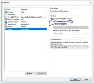

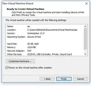

When you first install Ubuntu using VMware, there is a dialogue box new virtual machine wizard you need to select, customize hardware. See this screenshot:
screenshot
Now, go to display and select specify monitor setting and select a resolution according to your system. You can see in below picture then save this. See this screenshot:
screenshot
