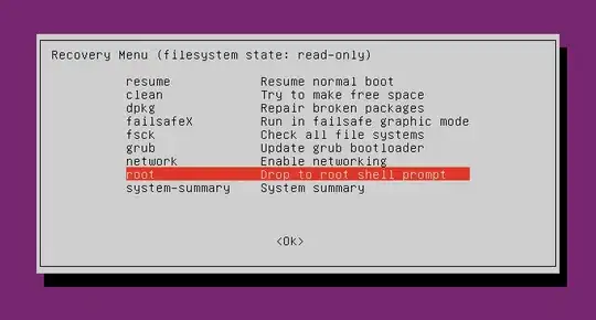

If pressing the keyboard combination Ctrl+Alt+F3 shows only a black screen, as you wrote in this comment: okay, so how can I use a tty? If I press Ctrl + Alt + F1 , I see nothing but black screen, where I can do nothing., there is an alternative way of getting access to a root shell when booting the computer without pressing Ctrl+Alt+F3 to bring up a tty.
  1. Immediately after the motherboard / computer manufacturer logo splash screen appears when the computer is booting, with BIOS, quickly press and hold the Shift key, which will bring up the GNU GRUB menu. (If you see the Ubuntu logo, you've missed the point where you can enter the GRUB menu.) With UEFI press (perhaps several times) the Esc key to get to the GRUB menu. Sometimes the manufacturer's splash screen is a part of the Windows bootloader, so when you power up the machine it goes straight to the GRUB screen, and then pressing Shift is unnecessary.
  2. From the first purple GNU GRUB screen select Advanced options for Ubuntu with the ↑ and ↓ keys and press Enter. You will then be prompted by another purple GNU GRUB menu that has a list of kernel options in it.
    GNU GRUB menu
  3. Press the down arrow key until you select the second entry from the top (the one with the recovery mode in the description) and then press Enter.
    Now you should see this recovery menu:
    recovery menu
  4. Using the arrow keys scroll down to root and then press Enter.
    You should now see a root prompt, something like this:
     root@ubuntu:~#
  5. At this stage you should have a read-only filesystem. You have to remount it with write permissions:
     mount -o rw,remount /
    Now you can run commands the same as in a terminal.
