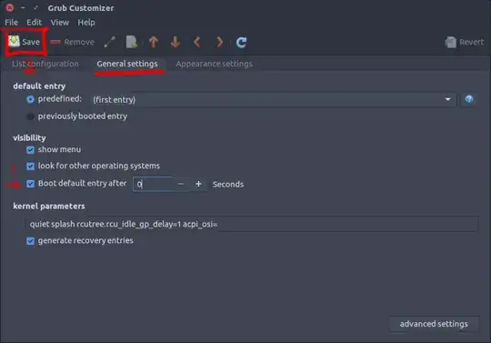

If you're not comfortable with editing configuration files, then I'd suggest installing Grub Customizer:
sudo add-apt-repository ppa:danielrichter2007/grub-customizer
sudo apt-get update
sudo apt-get install grub-customizer
Go to General settings tab. Then set the Boot default entry after field to 0. And press Save as shown:
Please don't change anything else, as it may break your system.
