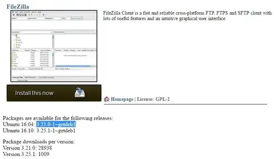

I'm trying to get 3.25.1 installed from GetDeb, but it's giving me 3.21 instead.
On the GetDeb FileZilla page, it says 3.25.1 is only available for Ubuntu 16.10, which doesn't make any sense.

There are two parts to your question.
1. Why is GetDeb only installing FileZilla 3.21.0-1~getdeb1?
Because that is the only version available in the GetDeb repo for Ubuntu 16.04
GetDeb Filezilla

When I asked this question to the GetDeb admins, I was told that there was a dependency on libgnutls28-dev (>= 3.4.15) for the latest FileZilla. There is only version 3.4.10-4ubuntu1.2 in Ubuntu 16.04. This is why it fails to build there.
