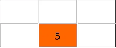

Viewports in Unity
If you are using Unity, the current viewport cannot be retrieved directly from
wmctrl -d
since Unity has viewports, which are not detected directly by wmctrl -d. The output will show only one workspace:
0  * DG: 5040x2100  VP: 1680,1050  WA: 59,24 1621x1026  N/A
  • where my resolution is 1680 x 1050 (from xrandr)
  • the spanning workspace (all viewports) is 5040x2100. That is 3x2 viewports: 5040/1680 = 3 and 2100 / 1050 = 2.
  • I am currently on (viewport-) position 1680,1050 (x,y)
The script below calculates the current viewport from this information:
#!/usr/bin/env python3
import subprocess
def get_res():
    # get resolution
    xr = subprocess.check_output(["xrandr"]).decode("utf-8").split()
    pos = xr.index("current")
    return [int(xr[pos+1]), int(xr[pos+3].replace(",", "") )]
def current():
    # get the resolution (viewport size)
    res = get_res()
    # read wmctrl -d
    vp_data = subprocess.check_output(
        ["wmctrl", "-d"]
    # get the size of the spanning workspace (all viewports)
    dt = [int(n) for n in vp_data[3].split("x")]
    # calculate the number of columns
    cols = int(dt[0]/res[0])
    # calculate the number of rows
    rows = int(dt[1]/res[1])
    # get the current position in the spanning workspace
    curr_vpdata = [int(n) for n in vp_data[5].split(",")]
    # current column (readable format)
    curr_col = int(curr_vpdata[0]/res[0])
    # current row (readable format)
    curr_row = int(curr_vpdata[1]/res[1])
    # calculate the current viewport
    return curr_col+curr_row*cols+1
print(current())
To use:
  1. Install wmctrl
    sudo apt install wmctrl
  2. Run it by the command
    python3 /path/to/get_viewport.py
    It will output 1, 2, 3, or whatever the current viewport is. It automatically counts rows/columns your viewport configuration may include.
Explanation
The script
  • gets the size of one viewport (resolution) from xrandr, including possible extra monitors.
  • gets the current position on the spanning workspace
  • galculates the number of columns /rows in your viewport setup
  • from that, it calculates the current viewport
