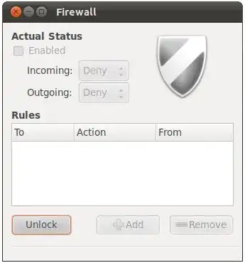

You will have to change the policy to first deny out going , then allow the ports you want.
gksu gufw
When you open gufw, it will look like this
Default
Enable the firewall by clicking the "Enabled" box
Deny Incoming and Outgoing.

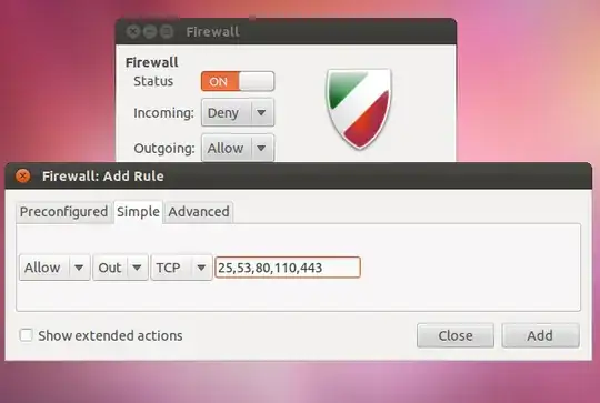

Add a rule for the ports you wish to allow (80,443,53)
You can add a simple rule, and list your ports, it will look like this

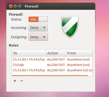

Final result
Final
