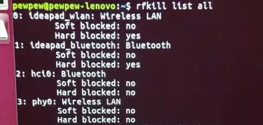

Edit: Ran rfkill list all: enter image description here
Also my laptop is a Lenovo Y520
