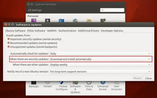

In the Update Manager click the Settings button. This dialog will show up:
screenshot of Download and install automatically security updates
Select the "Download and install automatically". This will automatically install security updates. If you want to set this up for them remotely via, you can do this:
