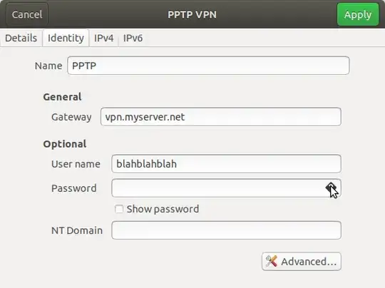

In Ubuntu 18.04 and previously in 16, you can allow saving of the VPN password by clicking the question mark
ubuntu vpn settings
This lists your options including:
  • Store the password only for this user
  • Store the password for all users
  • Ask for the password every time
  • The password is not required
If you choose one of the first two it should save the password for you.
The changes will also show in: /etc/NetworkManager/system-connections/{VPN Connection name} file
