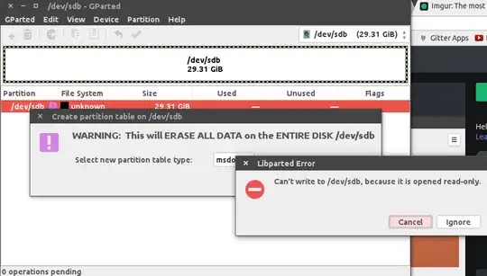

This issue happened for my 32 kingstone flash drive. I tried to make bootable USB by using dd command:
sudo dd if=file.iso of=/dev/sdb
After that I can't do anything with my USB stick.
When trying new partition table with GParted:

Looks like the drive is mounted somewhere:
Can't write to /dev/sdb, because it is opened read-only.
Please run
sudo umount /dev/sdb
and try to repartition again.

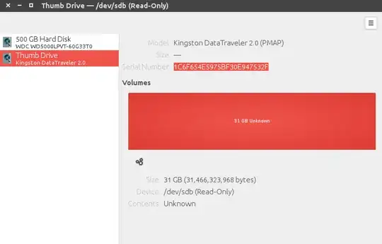

Cloned live-only USB boot drive
When you clone an Ubuntu iso file to a USB drive, the USB drive will be a bootable live drive, that can be run to 'Try Ubuntu' or to install Ubuntu into an internal drive. dd is a cloning tool, when used as described in the original question.
There are other cloning tools that are safer, for example 'Disks' alias gnome-disks, the 'Ubuntu Startup Disk Creator' in Ubuntu 16.04 LTS and newer versions, 'mkusb' and 'Win32 Disk Imager'.
USB drives that are cloned from iso files have the ISO9660 file system which is read-only. This is a feature of the system, that can be used on CD/DVD drives and it is inherited when cloned to USB drives.
