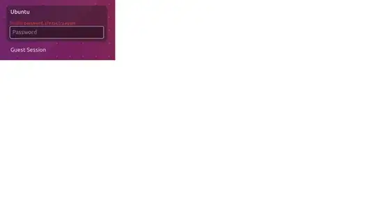

I have been having problems trying to install ubuntu-desktop on my VPS Ubuntu server 16.04
This is what I did:
sudo apt-get update
sudo apt-get upgrade
sudo apt-get install ubuntu-desktop
Then, I added a password to the root account. I read that I had to do that to access the Ubuntu desktop. I did this:
sudo passwd root
sudo passwd -u root
When I restart the Ubuntu server, I get the field to enter the password only. the option for username does not appear. I get this, but it says that the password I entered is incorrect. But it is correct.
Zanna
  • 72,312
Victor
  • 31
It's not correct you need to use the root user.
The username is already selected, it's basically a list of usernames (actually it's the "Real Name"). Your "Real Name" just happens to be: Ubuntu.
You could check the contents of /etc/passwd to see which username has that Real Name. And if you don't know that users password, then set it.
