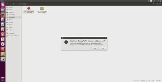

I installed ubuntu in my virtual machine (Oracle Virtual box) and when i try to install VNC Viewer then it shows:
error message
when I try to search no applications are found.I could not figure what is wrong here.Any help is appreciated.

The process involves two steps:
  1. Download the needed files from here or any other location.
  2. Then make file executable with:
    chmod +x VNC-Viewer-6.0.2-Linux-x64
  3. Then move it to say your home directory and run it from there, or any other location:
    mv VNC-Viewer-6.0.2-Linux-x64 ~/
    ./VNC-Viewer-6.0.2-Linux-x64
Note: You don't install you just run it.
Source:
https://www.realvnc.com/download/viewer/linux/
George Udosen
  • 37,534
There are many VNC clients. Some have the same vncviewer executable. One is TigerVNC which is available in the package manager:
sudo apt install tigervnc-viewer
vncviewer <ip>:<display/port>
