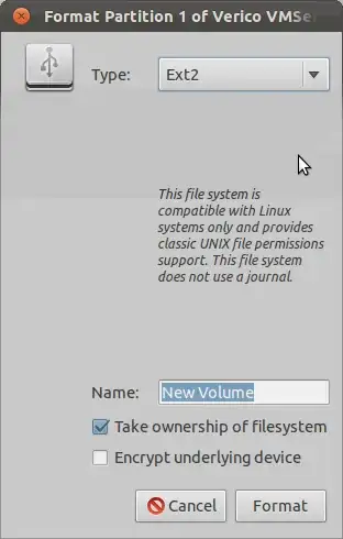

Plug your hard drive. Open Disk Utility. Choose the drive. In format Type option you will have ext2 option format it. [You may need to unmount it before formatting]
