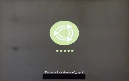

I'm on Ubuntu MATE 16.04.1 and I changed graphic card to GeForce 8600GT and now I can't enter LUKS password on boot after installing NVIDIA propriatary drivers (I tried 304.135 and 340.102). Keyboard does not work there, I only have such screen and I can't enter anything:
To boot my OS I need to go through recovery mode and it boots fine, but I would like to fix it by perhaps changing that passphrase screen to text-mode. I know that there should be such mode for this as I have it on another machine with another GeForce, only thing that it's on 14.04 and it switched to text-mode automatically right after installing NVIDIA driver.
How do I do this on 16.04?
PS. I've tried THIS solution (both wxh and text) and it does not work for me - not any passphrase screen appears...
