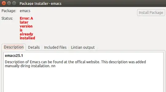

But, not to worry... that tutorial provided me with the .deb package. I had a look for ways to use this local package, and plumped for the gdebi variant. Trying to execute this, I see this:
Or on the command-line:
user@user:~/Downloads/emacs-25.1$ sudo gdebi emacs_25.1-1_amd64.deb
Reading package lists... Done
Building dependency tree
This package is uninstallable
A later version is already installed
