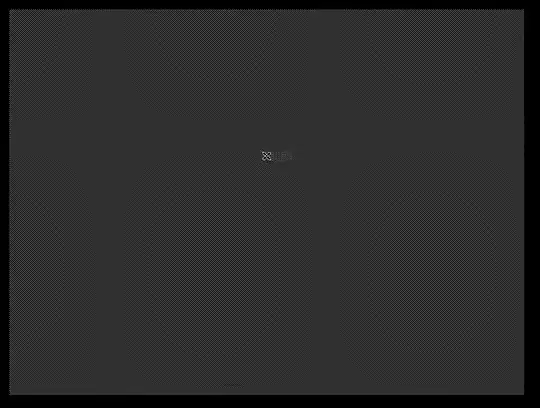

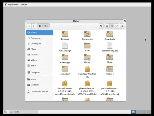

I can perfectly connect from my Windows machine using Putty and a SSH tunnel like explained here, but the outlook is not at all what I would desire. it is like that : VNC session outlook
and if I uncomment the 2 lines at the top of the file, I get that enter image description here
What am I doing wrong?
