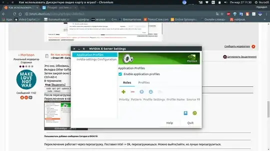

How can I launch games using a second video card? And why do I have few options in Nvidia X Server Settings?
Zanna
  • 72,312
Considering Nvidia X Server Settings screenshot it seems there is a lack of PRIME Profiles item along those two items I see. Once I've met with this situation when I had Secure Boot enabled in my BIOS (UEFI). So my advice is try to find Secure Boot in your BIOS (UEFI) and disable it. After rebooting you should see PRIME Profiles where you can choose which video card should be active.
Here are some explanations on the subject: Why disabling “Secure Boot” is enforced policy when installing 3rd party modules
