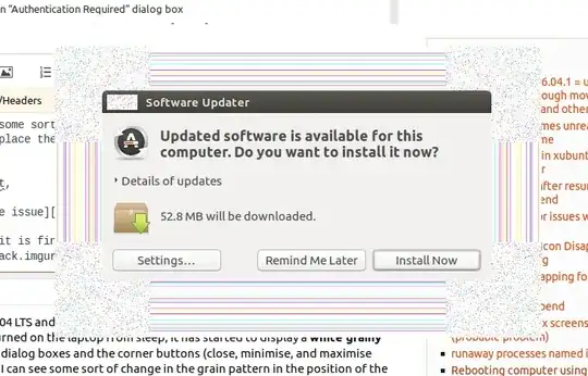

I am running Ubuntu 16.04 LTS and it was working fine. There was not any issue with the display. But today morning when I turned on the laptop from sleep, it has started to display a white grainy background around the dialog boxes and the corner buttons (close, minimise, and maximise buttons) are not visible. I can see some sort of change in the grain pattern in the position of the buttons when I place the mouse over the buttons. The buttons are working though.
The display around it is fine, as you can see.

This issue is present in 375 and 378 drivers...
Given that simply killing compiz process fixes the bad border problem, I have tested a solution that works on my Ubuntu 16.04 system every time after the system wakes.
Step 1:
I created a script called fixbadborders in the directory /lib/systemd/system-sleep. It contained the following:
#!/bin/sh
## This file (or a link to it) must be in the folder /lib/systemd/system-sleep/
## Purpose: Kill compiz after system wakes up from sleep.
## This will fix bad window borders caused by Nvidia driver 375.39.
kill $(ps -C compiz -o pid=)
Step 2:
Allowed the script to have execute permission with:
sudo chmod +x fixbadborders
