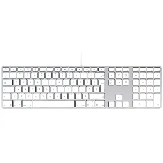

I am using the Mac Canadian Multilingual keyboard with Ubuntu 16, shown below. The Canadian Multilingual text entry option works almost fine, but I have the following problems.
  1. The left alt and right alt are swapped. I have to press on the right alt key in order to write the brackets { and } (that makes coding and writing in Latex very difficult).
  2. The keys for ù and / are also swapped.
How can I fix this? I tried everything suggested in the related posts on this site (and elsewhere), to no avail.
