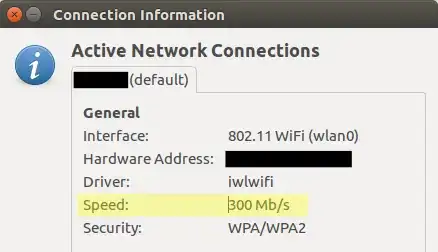

I've been running 16.04 LTS on an old Lenovo T410. I'm finding that my network connection status varies a lot. I'd like to have an easier way to see what level my wifi is connecting at (300Mb/s, 150Mb/s, etc.) from moment to moment without having to dig down to Network Indicator>Connection Information>"Speed" every time.
Here's the output I'm looking to put in an indicator
connection info

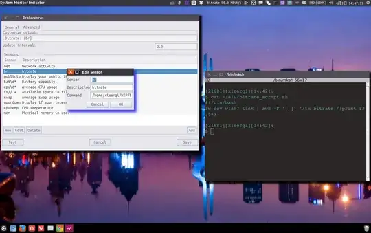

To be precise, the indicator has several settings in the preferences which it calls "sensors". For instance, if you set to display CPU: {cpu} it would display CPU as text and substitute actual percent of CPU usage instead of the curly braces string. The great thing about it is that by clicking New button, you can add a custom script to be displayed as "sensor".
In the screenshot you can see that I've added my custom script as br sensor formatting string , and for Command I've given full path to the script which lives in my ~/WIP folder. There is nothing special about that folder, it just happened to be location for the stuff on which I currently work ( Work-In-Progress, basically ). Users however are usually encouraged to place scripts into ~/bin folder, thus I would recommend you do that.
If you have followed the instructions properly up to this point, you should have indicator-sysmonitor show the bitrate just like in the screenshot.

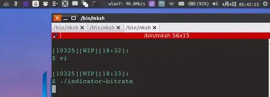

Solution 2: Custom indicator using Python and Network Manager's dbus properties
indicator-bitrate in action
I wasn't quite satisfied with the above solution, which relies on indicator-sysmonitor and a custom script. I wanted to have a singular indicator which does the job all from within itself. Hence I've written an indicator of my own in Python 3 , which relies on information that Network Manager exposes via dbus interprocess communication system. In short, the big work is done by Network Manager - we just use the information it provides. Advantage of this indicator is that the user doesn't have to define the wireless interface to be used - it's done automatically.
Theory of operation
Indicator effectively repeats same action - the get_bitrates function every 1 second. That function queries dbus properties on several interfaces in sequence. First, it obtains all devices and filters out 802.11 wireless devices. Next, we iterate over each wifi device and query their name and bitrate. Everything is built up into one string of text which is then displayed on the indicator label.
In theory, the indicator should be able to determine bitrate for multiple wireless interfaces. For instance, users may have internal PCI-e wireless chipset, and USB chip. Unfortunately, I did not get to test this due to issues with my laptop , as well as due to time constrains. I may test this on another laptop once I have the chance and will edit the answer accordingly.
