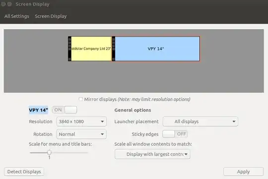

I'll include a pic of what I mean to clarify:
That very wide monitor on the right is actually two physical monitors. The graphics card just treats them as one monitor.
Obviously this is pretty annoying since I can only full-screen things on the far left monitor.
