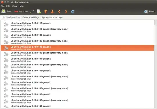

If your intent is simply to select a kernel already on the grub menu as default, I think you'll find the powerful grub customizer by Daniel Richter quite useful.
grub-customizer
You can right click on a kernel entry in the list configuration and choose to move it up or down or edit it.

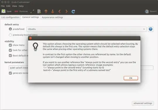

On the General Settings Tab, You can easily select and set the default entry by name from the list of predefined entries (as you indicated in your question.) See the image below for an example:
GC-General
Save your changes and reboot and enjoy your new default boot entry.
