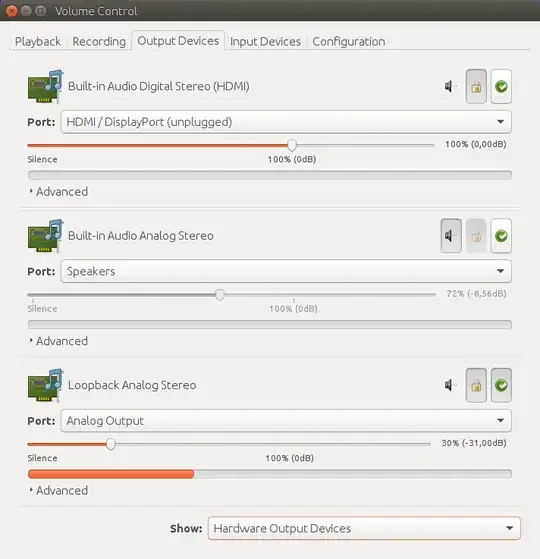

Then I confirmed, that the sound is routed to the loopback device: Screenshot of pavucontrol
Unfortunately, the flash plugin doesn't see the sound at all - as if I was recording zeroes.

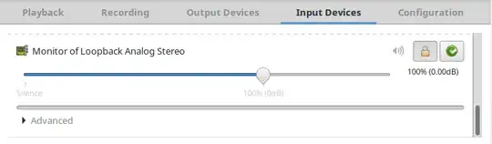

So pavucontrol shows (and selects) two loop devices, one playback (hw:2,0) and one record (hw:2,1):
You cannot select the playback device in pavucontrol, so it selects device 0:
You will see this when loking at the playback device file:
user@desk:~$ lsof | grep /dev/snd/pcmC2
pulseaudi 3314               user  mem       CHR             116,13                 556 /dev/snd/pcmC2D0p
pulseaudi 3314               user   48u      CHR             116,13      0t0        556 /dev/snd/pcmC2D0p
alsa-sink 3314 3320          user  mem       CHR             116,13                 556 /dev/snd/pcmC2D0p
alsa-sink 3314 3320          user   48u      CHR             116,13      0t0        556 /dev/snd/pcmC2D0p
So this means the capturing of this audio stream has to be done via /dev/snd/pcmC2D1c; if you select loopbackas the input device for flash, it will use /dev/snd/pcmC2D0cinstead (plugin-comeans the plugin container flash is running in):
