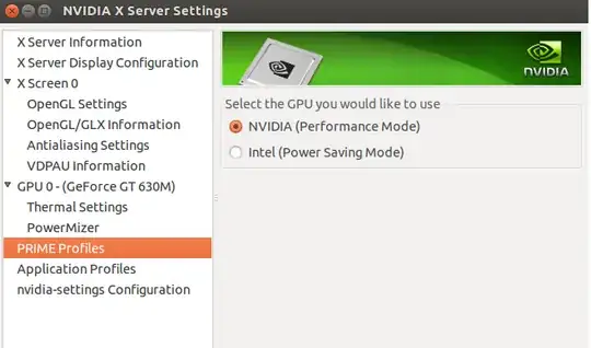

Another option is prime which works fairly well but only seems to support nouveau and requires an X-Server restart to change the active GPU. To install prime, open up a terminal window and type the following:
sudo apt install nvidia-381 nvidia-prime
After installing prime, you should have a window that looks like this: PRIME
Your third option is to install reverse prime although I would not recommend that as it sets your NVIDIA GPU as your default GPU and will drain your battery like crazy.
