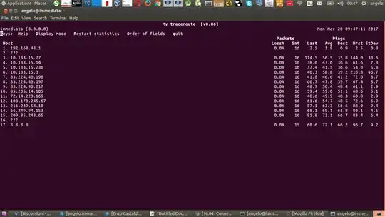

rtt min/avg/max/mdev = 66.755/68.888/72.227/1.776 ms
mtr 8.8.8.8 output mtr 8.8.8.8 output

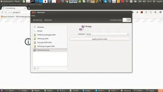

But I unselected the proxy as showed in this image Proxy unselection

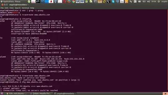

UPDATE 2
In the following image there are the results of traceroute and dig commands
Traceroute and dig results

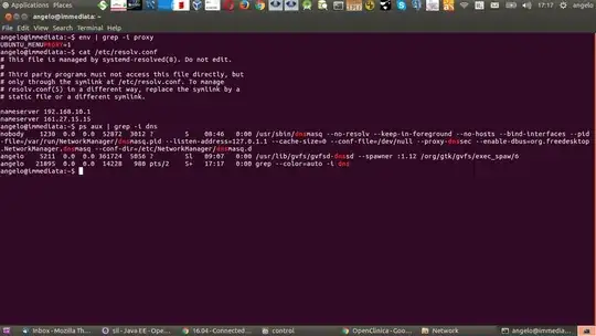

UPDATE 3
In the following image you can see the result of cat /etc/resolv.conf and ps aux | grep -i dns
Cat resolv.conf and ps results

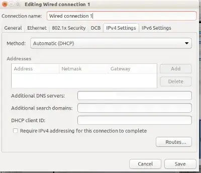

Proofread carefully, save and close the text editor. Next, click the Network Manager icon and select 'Edit Connections.' Select your ethernet connection and go to IPv4 settings. Set the Method to Automatic (DHCP). If there are any present, remove any other entries such as DNS nameservers.
Do the same process with wireless. Save and close the edit window. Here is an example of the correct configuration:
