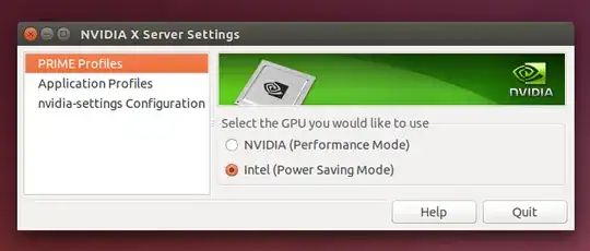

What you have is a hybrid graphics card popularly known as Nvidia Optimus technology.
If you install the nvidia graphics card, you will still have the default intel graphics drivers. You can switch between the two from Nvidia settings.
Unlike Windows where it works dynamically, you need to switch between Nvidia and Intel from the Nvidia app then log out and log in for the settings to work.
