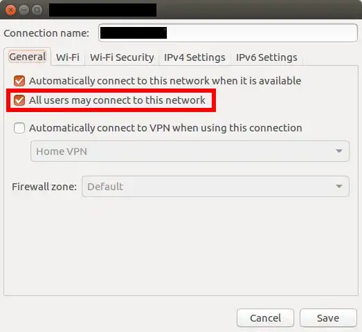

By default, connections are not shared publicly with every user on the system. In order to permit this, you need to manually enable this, which can be done either from the GUI or the terminal.
GUI Way
  1. In the Network menu of a privileged account, select the Edit Connections option.
  2. Select the wireless network you would like to share. Go to the General tab.
  3. Select the All users may connect to this network option (see screenshot)
  4. Click Save.
